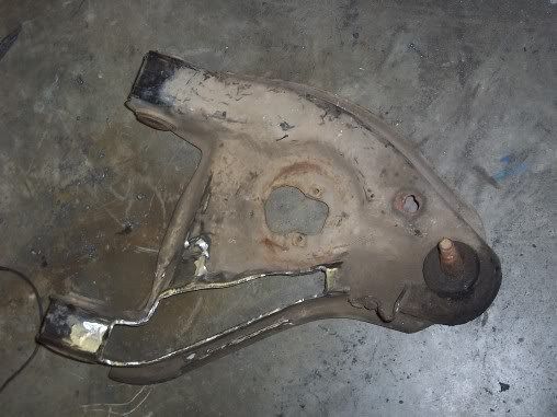

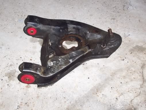

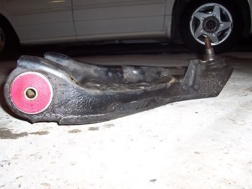

Onelofullsize
i wanna see some pics of factory lower control arms that are modded to lay a 22 with a bodydrop on a obs fullsize, close up pics or even a description on how you did the mod

i modded some but no pics. ur gonna have to notch on both side where it hits the frame,thats what i did then re-plated where i notched.

Onelofullsize
hey kyle how much did u end up taking out of the control arm? what size tire are u runnin on your 22's up front?

It's been at least a year since I've done them, and I eyeballed where to cut, so no exact measurments. I'd say somewhere around 1/2 to 3/4". 265/35/22 all around.
