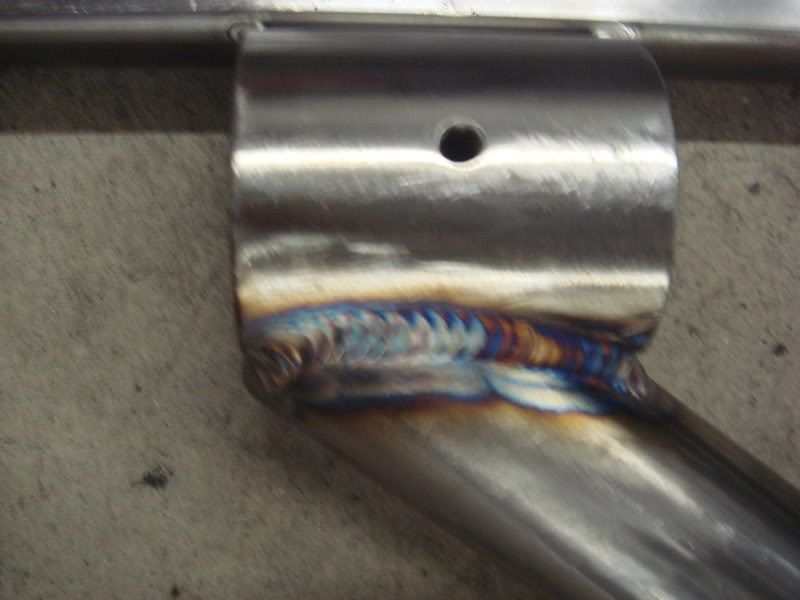

let see some pics and I could tell you what the deal is..........

I'm pretty sure that Brooks can answer your questions, you can't accidently weld like he does.
I use a gas lens on just about everything. I run a low CFM rate too, about 15ish.
