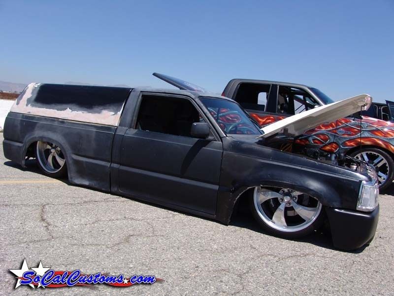

maybe your confused, mazda on 20s is not the problem, its mazda on 22s that people converse about, mazda on 20s is nothing hard and has been done plenty of times, mazda on 22s is the issue you might be reffering to. here is a dawg on 20s.
