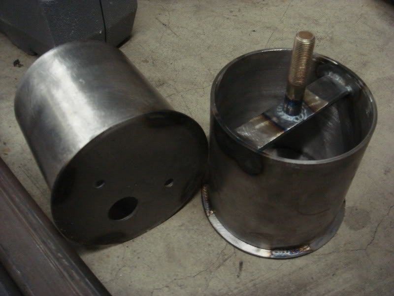

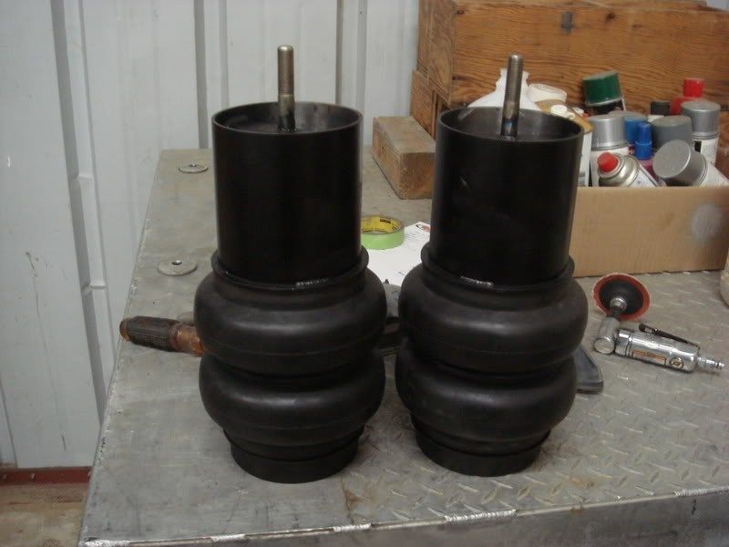

i put an re7 up front with a 5" tall upper cup and it fits beautifully, only had to trim off the factory bumpstops and round the corners off stock coil cup for additional safety. used stock control arms, drop spindles, a 5" upper cup and a 1" lower cup and it lays out on a 265/40/22, with enough for a 2" body drop.
