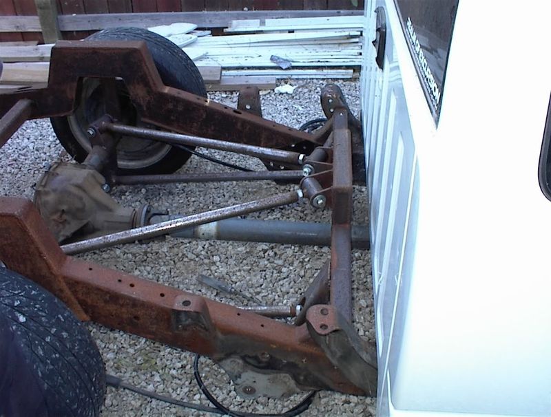

Ive got a triangulated 4 link. My problem is that there is to much play in the bushings on the upper bars on the axle side. What can I do to fix this?

Call Jack at HMEngineering.com and tell him what size your bushings are, he can sell you delrin bushings to replace your eurethane with. Keep in mind that delrin has very little give so it will limit your "side hitting" ability. If you do hit sides with it you will at some point have to beef up what ever is the next thing to flex. You might need to convert over to heims if have your heart set on sides. It looks like you could just tun the upper bar around and thread a heim into the bar and run it that way. Many options...
are the bottom bars angled in? if so that could be the problem. one set of bars should be straight. usualy the bottom set.
