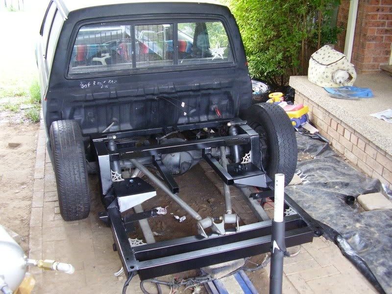

So do you belive there is an idea solution for a vehical such as mine... with space issues? I do want to move away from the rear facing setup as it has had some lateral issues (the bars are too long and not triangulated enough which does not help)...This is the best I've been able to come up with to now...
granth
wow, thats crazy. thats a cool truck man. your gunna have to notch the cab one way or antoher for it, it looks like....if you want front facing.

I've actually notched it somewhat already for the tailshaft... The front is still up too so there may be futher issues when that comes down?I've never understood exactly how a two link works...? Anyone care to expalin?
