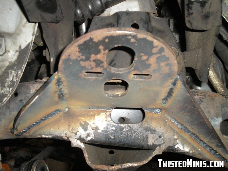

You have to use the stock lowers for sure. I completely cut out all of the stops and put in the upper plate with gussets for the bag. take a look at my profile, my build pictures are still on there... Good luck and thanks for keeping it clean and converting to air...lol

o so those pics really dont show alot but all u have to do is cut all the stuff off the frame and mount the upper bag and bolt the bottom to the arm, dont forget to angle the upper bag mount, hope this all helps u out .......low intentions 4 life

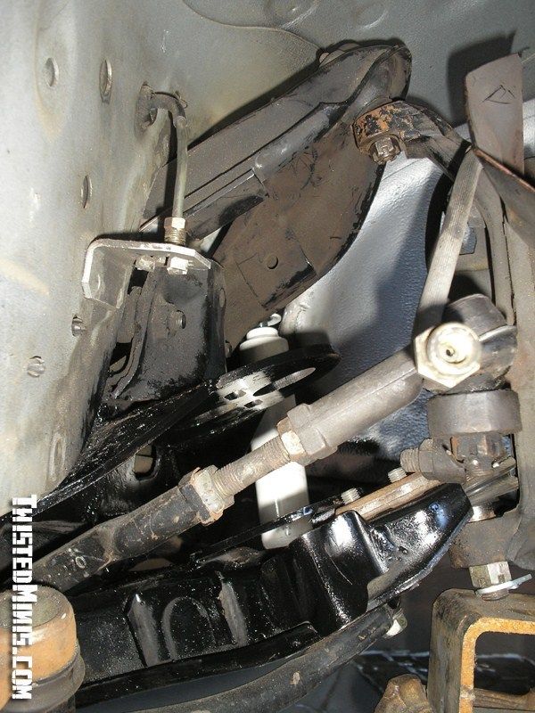

This might help?
