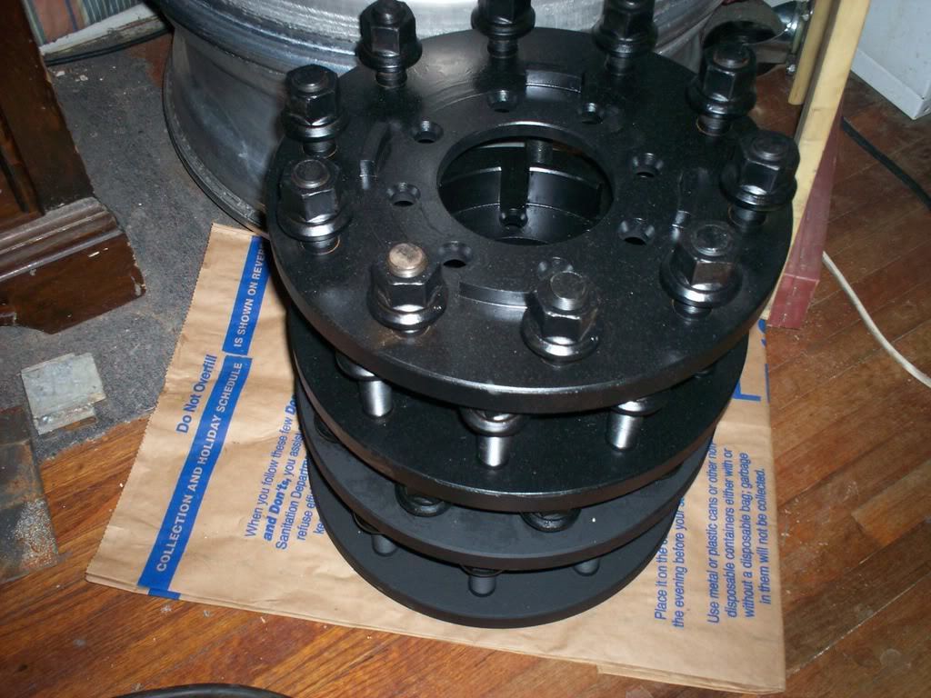

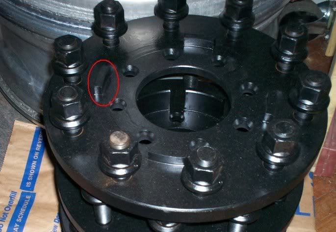

My adapter look almost identical to these (I hope Wide Load C-30 Doesn't mind me using his picture)
One thing I can't tell is the lug holes in the adapters look like they are coned for a normal lug nut
Mine are not they are completely flat is this normal?

Yeah, your adapters are normal. The adapters on my Ford were flat too. In fact, I think these are the only adapters I have seen that are not flat. I bought the adapters for my squarebody (the ones in your post) off of craigslist. They are steel, hubcentric, and in great shape, so i bought them. The guy I bought them off of was running them on an 87 CC dually lifted on 22.5's. I want to run the washer style lugnuts on these adapters though.

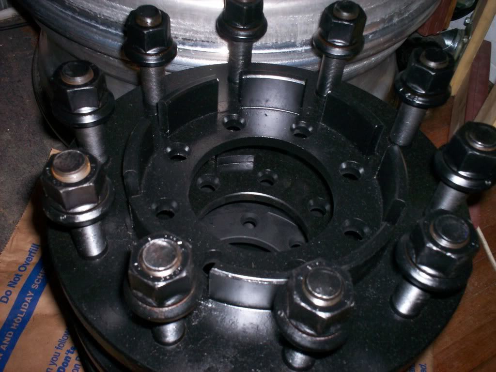

Another thing I am curious about the part that holds the 10 lug rim concentric (circled in my pic) is the same width on all my adapters, but two of the adapters have way longer studs. The truck came w/ four 22s and two teenagers but I want to swap all six to 22s. Will I need to get different adapters for the rear?

The picture you have is of one of my front adapters.
Here is a pic of one of my rear adapters:
And if your adapters are flat you should run the washer style lug nuts.
