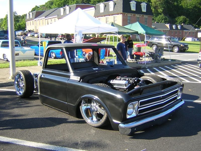

LIKE THIS GUY?

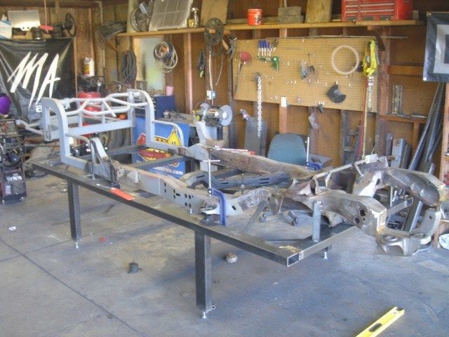

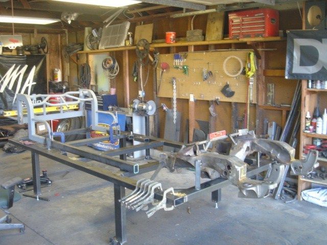

Heres what i do personally.
In my opinion, you need to use a frame table of sorts. Lots of people have built them on the ground, and they have been successfull, but having the frame on a table makes it that much easier to work with .

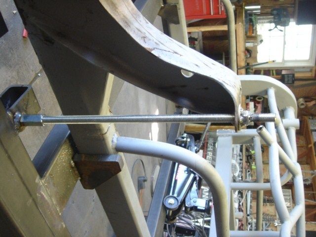

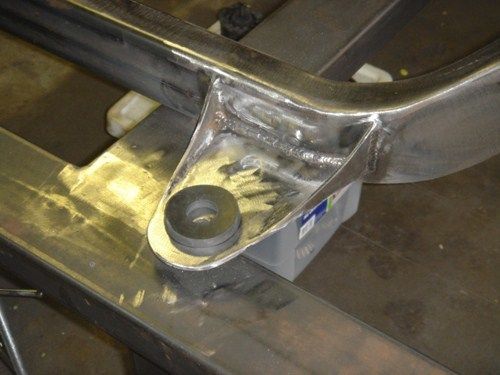

I layed my frame on the table i made. Then welded some tabs to fix the front end and the rest of the frame directly in place. I then welded nuts to the table directly under each bodymount, and ran a piece of threaded rod through the body mount location, then got a piece of steel like a washer to weld on the rod to mark the height of the stock bodymounts. After i marked all the heights, i cut the frame off ware i wanted to start the new frame. Layed my 2x3 out, and then threaded the bodymount markers back into their spots and put a spacer on them to drop the height of each location the amount i want to bodydrop the truck, then my new mount would but right up to that and go from thare.
idk, if thats confusing or not. check this profile of mine for more pics Http://www.streetsourcemag.com/Profile.aspx?ProfileID=42921
heres some pics:

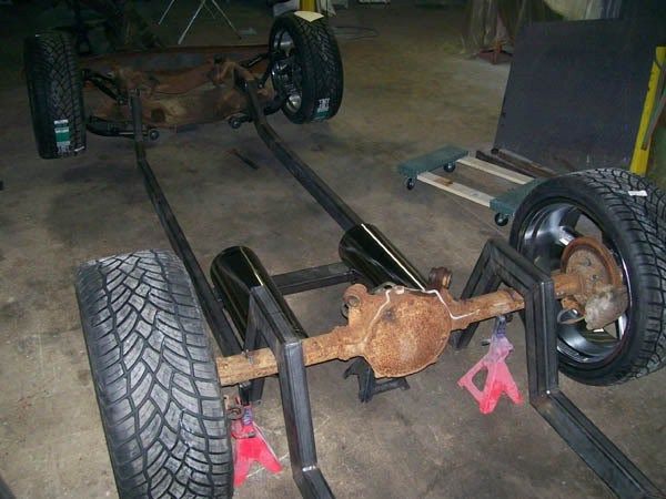

THANKS TAYLOR! OKAY SO IN YOUR 4TH PIC DOWN DID YOU JUST LAY THE CROSS MEMBER ALL THE WAY DOWN THEN SET IT LEVEL AND CUT OFF WHERE YOU WANTED TO BUILD THE NEW ONE? SWEET FRAME BUY THE WAY

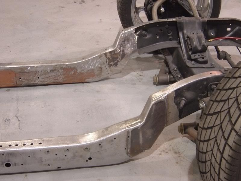

here's one haggard just did
my frame didnt need to be "Z" cut, S-10 trucks lay flat frame without any issues. So i just layed the frame flat, and jigd' it in place, then cut it ware i wanted it.
BUT

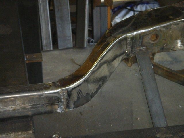

I did just do a toyota at the shop that needed to be Zed, I just layed the front x-member flat on the frame table, the rest of the frame didnt lay out with it....so then leveled the rest of the frame, jiged' the front section of the frame in place, marked the bodymounts, and then cut off what i didnt want. then layed the new rails flat on the table in orientation to the rest of the frame, and welded it up.
Pics:
s10
