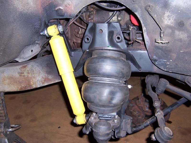

not my truck, a buddy of mine!

damn dude, didnt pay attention to the 1983 part, oh well!

hey russell do u have a btr pic of how u mounted the shocks? ....

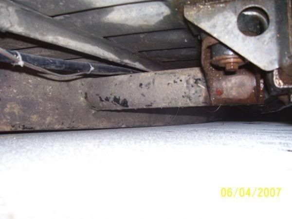

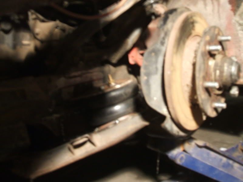

Yea russ,there stacks of photos kicking round of the 85 onwards but i cant seem to locate any oldschool front setups,having probs with my lower arm mounts

there you go Eric, just made that same pic bigger. keep in mind i didnt do any of the work on this truck, a buddy of mine did it for another buddy. and wish i could help you more Nasty, but those older Mazdas arent as common.

well frist off you cut that big a$$ spring pocket off cover that hole and use the basic set up for the top mount that fatboys s10 posted and i'm not rasieing the control arms or zing it onece your drag that little bit off the control arms it will lay crossmeber and it just barley dosent lay in the front but lays hard in the rear it will look something like this
but if you want it to lay all the way out im thinkin zing it would be easyestohh and talk to slammed83mazda he can help you alot too

thankx russ do u know if the bag rubs those bolts when ridn low cause i had that prob , and i want to flip my balljoint, but i think my bag will eat that those bolts up and tell ur buddy that shit lks good

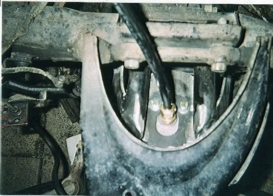

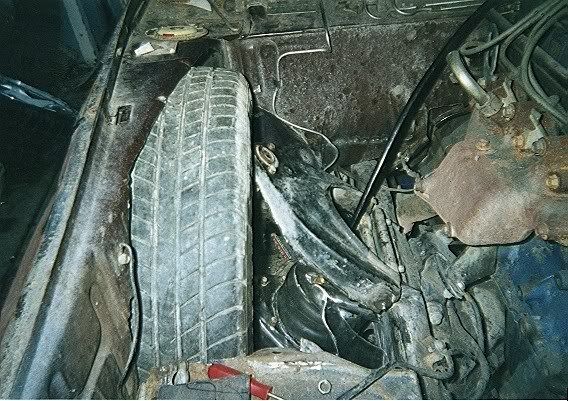

here are some picks of my old courier which has the same suspension i cut the factory spring pocket out and re-plated the hole then came up with a unique front bag set-up but torsion bar bag kit from ssd will work fine but make sure you angle them with the lower a arm and also i plated the lower a arm and raised the bag mount up 1/4" so the bags didn't rub the arm to much
sorry for the huge Pict's
