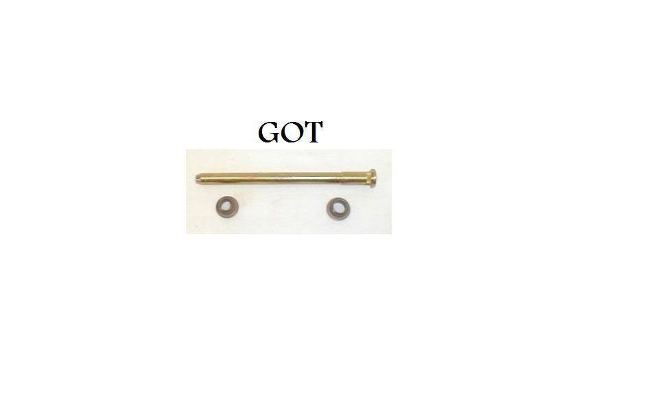

Is there a fix to get these doors solid? I think they are worse than when I got it....Just want them to stop making noise every time I hit a bump. Does the pin kit fix this? I hope and pray!
maz89
the pin kits only keep the door on and aligned. only way I imagine those would make noise is if the bushings and pins were wore out really bad, and rattled when the door is closed, your best bet is to get some 3M flexa foam, dynamat..
got6wls's avatar
got6wls
The pin/hinge kit will like Doordragr said only keep the door aligned. To make them solid and not rattle, you need everything in place such as new rubber/weather stripping, new felt(s), window tracks, guides and so on. I reaplced all this stuff on mine and now have no rattles or shaking, nice and quiet and smooth just like whan they were new. Also the door catch/striker on the B pilar should be replaced if worn down too much and then realigned.
