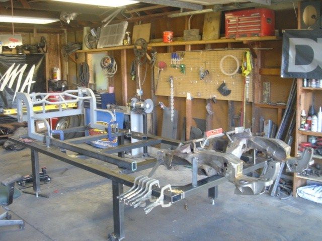

just wanted to see some photos of you guys frame tables/jigs that you are using.. im gonna start on my 720 soon and just wanted a good idea of what kinda of material and stuff im gonna need to build this table with because the floor in the shop isnt perfectly level..

Heres the one we use at the shop:
And heres mine at home:

Yeah be sure to mount some adjusters on the legs, comes in really handy when setting the table up when the shops floor is questionable. Easiest way is to weld a nut into the bottom of your table legs and then you can wind the bolt in which will give you plenty of adjustment.

thanks for the pics taylor.. just out of interest what are the dimensions on the tables you have pics of im thinking one that is 12' long by 4 1/2' wide will be plenty to do my ext cab 720 even with the frame extension for the long bed.. and thanks for the advice mat as well i had that in the plans but any help is always appreciated
