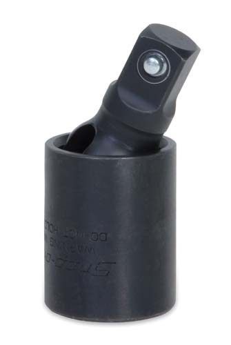

I put pressure on the ball joint so it has some friction and use a impact if you can. I have a snapon impact swivel that works great. Similar to this one, (mine is pretty old but still works great)

we called that the teethbuster at my old job.....
I second that, but still use them all the time, lol!
