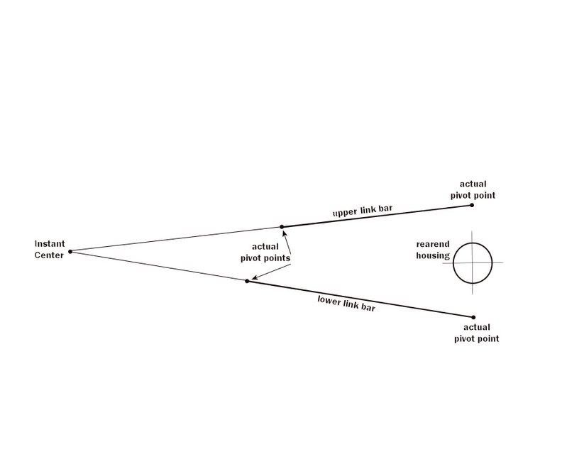

heres a pic from biomax's 4link article. the bars should point towards the front of the ride around the grille area. i would read the thread, it has a LOT of very usefull information.

The lower tabs on the rearend need to be longer and the upper wishbone mount on the chassis needs to be lower... there is no other way around it.
Your upper wish-bone is going to fight you, Why not just build a triangulated 4-link or a traditional 4-link with a pannard-bar? It will make proper bar placement much easier.
