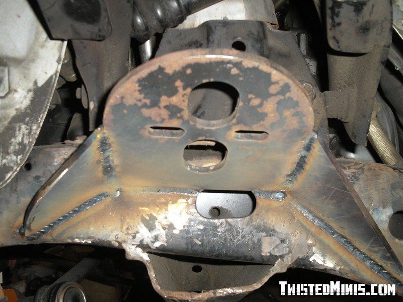

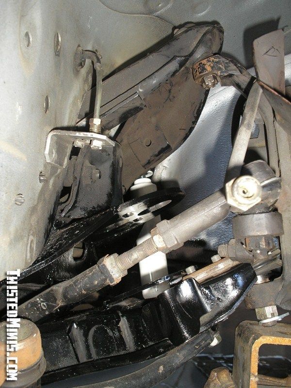

You have to cut your inner fenders, but its not that bad.And heres a picture of flipped balljoints and stock spindles laying a 24.5" tall tire.And don't forget to play that hole where you cut the bumpstops out. I don't have a picture of that really.
