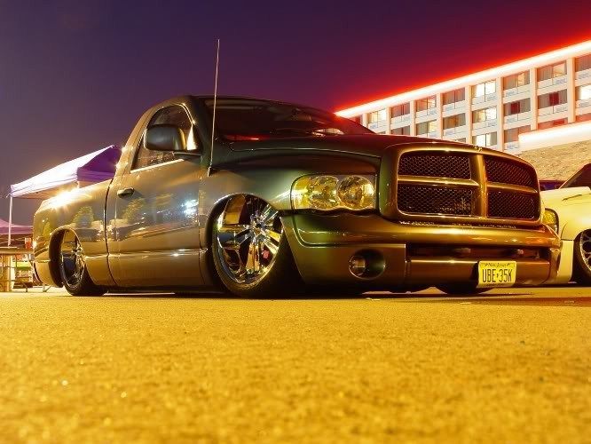

slammedram
here you go man i am sure i have better but i knew right where this one was.
