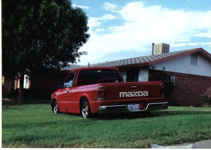

Heres a pic of mine back in highschool 98ish. It had DJM dropped control arms and cranked torsions up front, and the back was 3" blocks with the helper springs removed(just had the main leaf and the overload) and no bumpstops.It actually rode pretty nice except when the back bottomed out. the front crossmember was between 1 3/4" to 2" off the ground.
