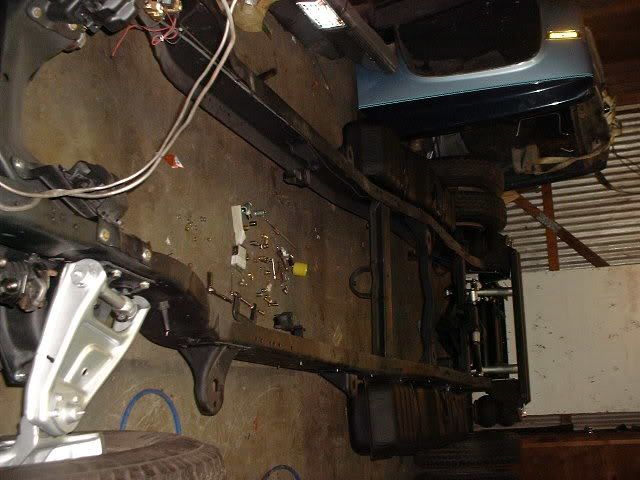

skidrow
look here for ideas

skidrow
works for me should take you to photbucket try agin your going to have to pick a folder over 1000 pics

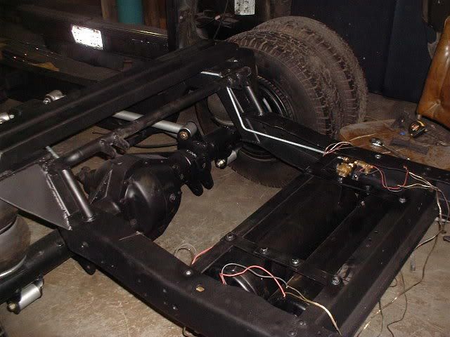

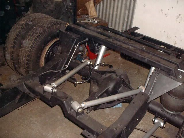

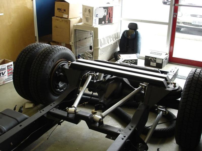

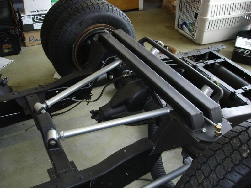

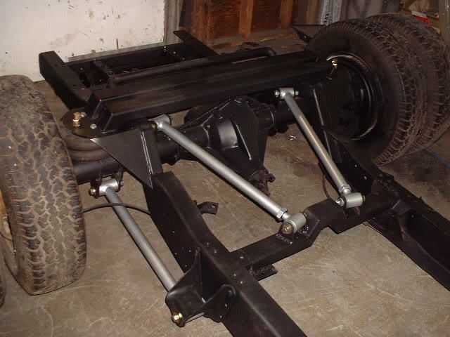

what yr model truck, i have a 2 link on mine also and have mny bags on the bars and i can pull a 20ft trailer with no problem over the axle is good also just personal prefernce if you go with a 2 link you link bars need to be at least 48 inches long i had mine made at suicide doors with the end a busging already in place and you will need to get a new axle saddle and mounting plate and u bolt, you can get the saddle and plate and ubolts from ekstensive metal works.. \
huskerdually
There are a lot of ways to link a rear end. If you are new to it I would recommend going here and reading as much as you can stand. People run lots of different lengths of bars. I think mine are going to be around 60". I know that is super long but I'm doing it for a couple reasons. I hate the wheel not being centered in the wheel well and I'm hoping to use the same crossmember for the front of the bars and the carrier bearing. If anyone can give me a good reason not to do this let me know, and soon cause hopefully guilty is going to have my framerail pieces done soon.(hint hint). I've drawn my entire setup to scale on graph paper and run through the entire range of motion to see if there are any surprises. You can also just run universal four link from any one of the companies out there and you will probably never know the difference.
The biggest thing is to just read and look at as many pictures as you can
