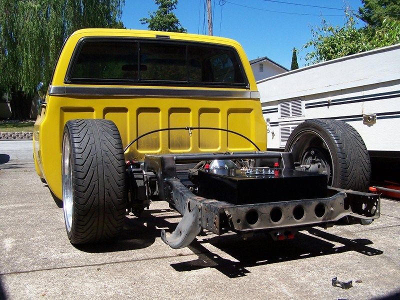

me my dad and my buddy scott spent last year building my nephews 2 wd k5. there is nothing to it if you have time and money to work on it

i do have 1 just looking to get some suspention ideas for the back since the wheel base is so short and te frame is relly narow

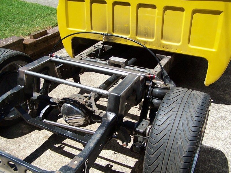

i know i am gonig to hear shit but we 2 linked it with the bags on the bars. it will lay the gas tank. we weldrd a bar from side to side at the end of the link bars the rear does not move one bit. but of course this way does keep from laying. i set it up so the shocks would bottom out and keep it from hitting the cross bar. checkout gaugemag and hotridesmag.com spring fling it is a blue and silver k5.

that looks nice its along the lines of what i was thinking its just a little harder because i have a unibody and no bed to take off did you have to cut your iner fenders to lay out?
