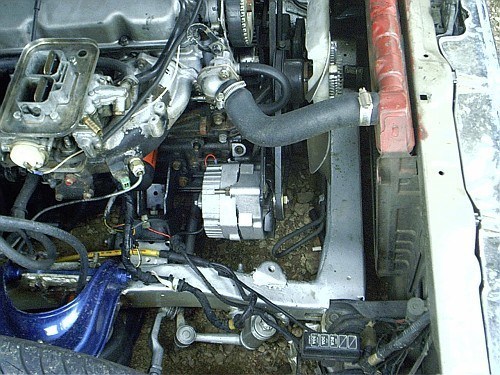

I was just wondering what year chevrolet alternator works with the 86-93 b-series? Couldnt find the post

I put one on my old one years ago. Never had heard of doin it or it being done.. I was just a cheap ass and a chevy 1 wire alt is soo much cheaper than a mazda one.. Just notched out the lower mounting bracket for clearance then mounted it upside down.. Here's a pic of it so give you an idea...
Sorry the pic is so big..

What year alternator do i need?

I went to a local battery and alternator shop instead of autozone or someone like that. I told the guy I wanted an 100 amp chevy one wire alternator to put on my mazda.He looked at my belt style,told me to come back the next day and he'd have it ready.
