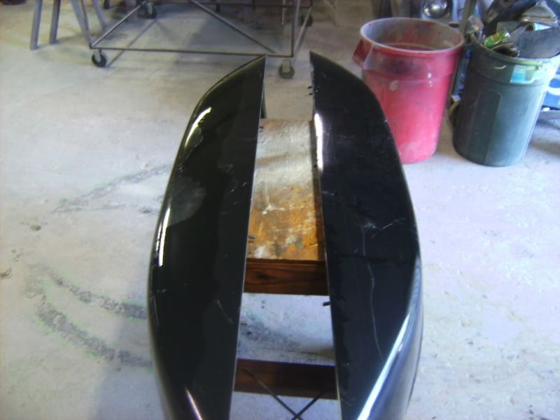

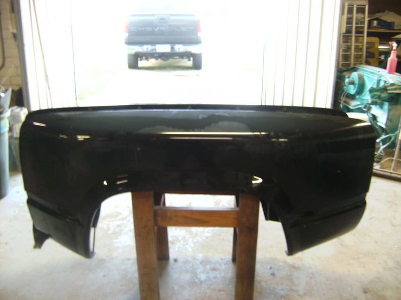

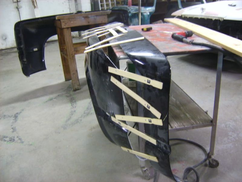

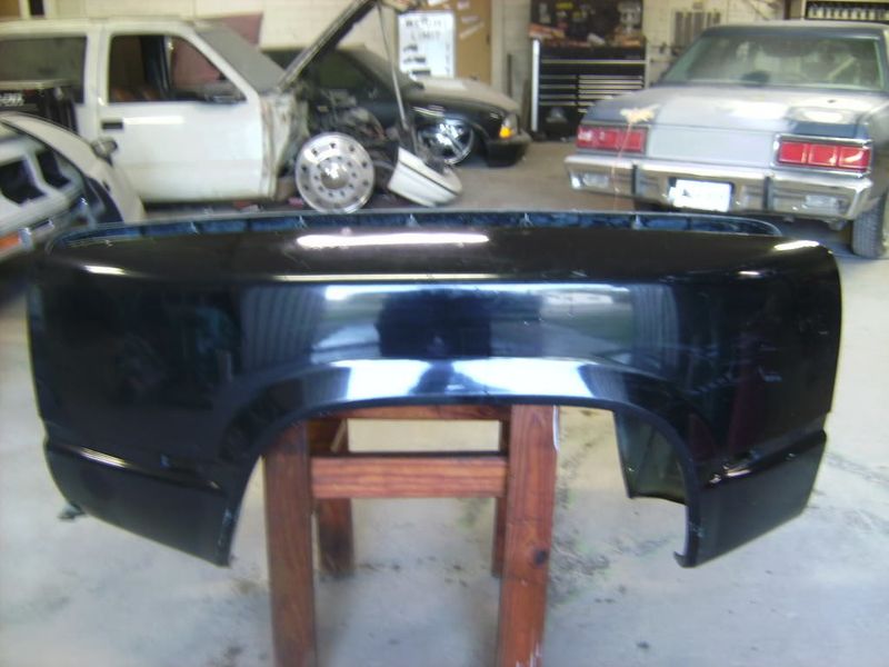

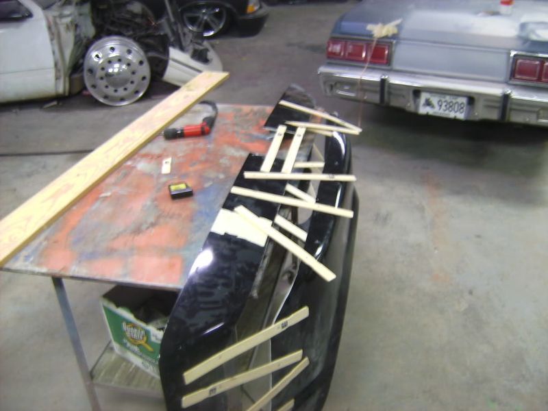

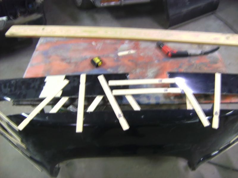

i went and picked up the fenders im stretching for ec dually today ill put some pics on here in a few minutes as soon as they load on photobucket

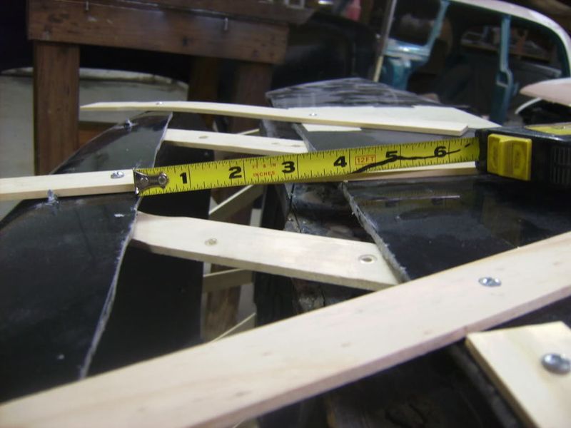

good lord do you have to stretch them that much?? I thought it was like 2''
1low1ton
he wanted them stretched 3 and 3/4 inches so thats what im doin

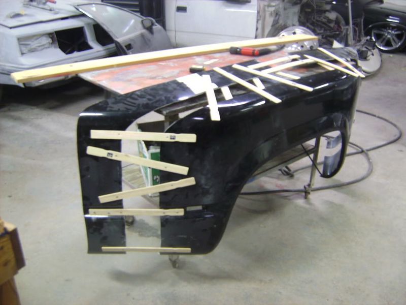

i stretched mine 3 1/2 inches and it wasnt enough i had to mill the faces of my wheels down to get the extra room.
E
ec_dually
i wanted to be sure and have enough room after asking several people who had strecthed fenders i wanted to make sure i was going to have sufficient room and after talking to sean we both agreed 3-3/4 would be best...
E
ec_dually
also with not know if i havethe wider rear i wanted to make sure also may be a lil overkill but better to cut once then to do it and then come up short
