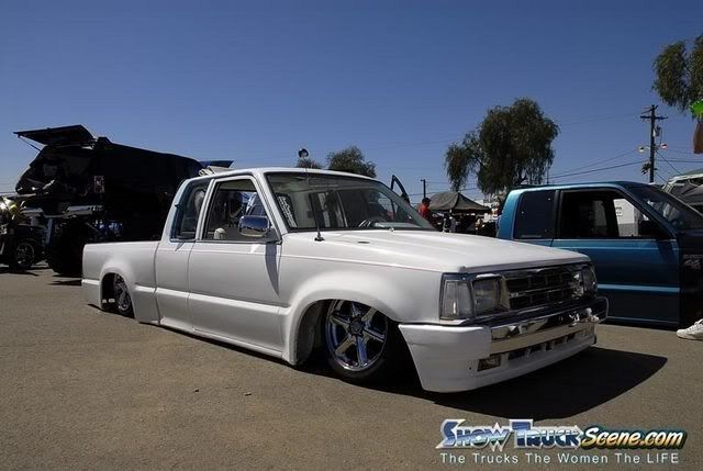

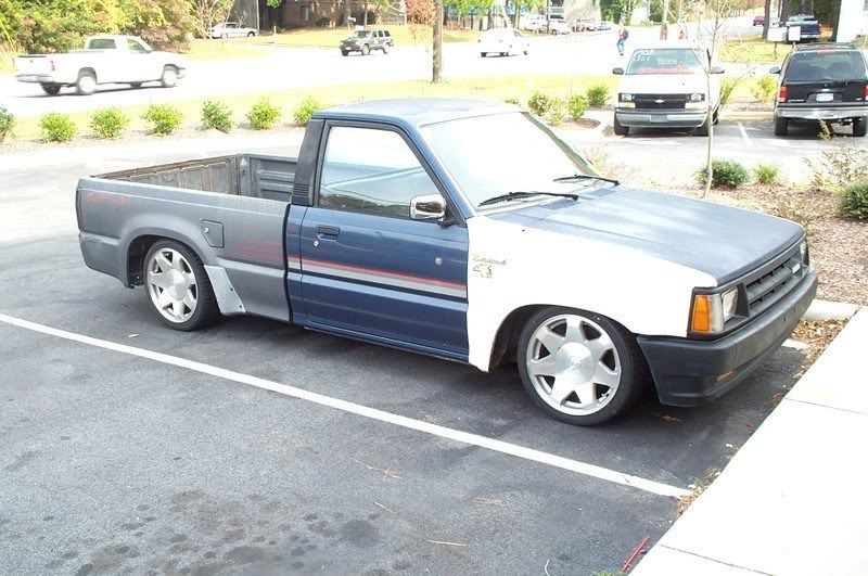

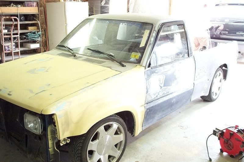

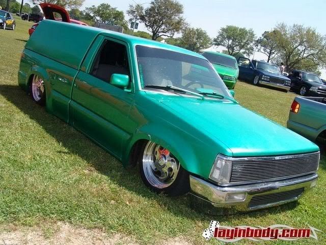

Edited: 4/10/2007 12:05:30 AM by smcprez
I found these...sorry for copying them off other sites, but you can see the difference!

if i put the 18's with the 2wd sheet metal what all do i have to do? justpull on it a little or fab up some flares or something. Like can i just break the mounts make a little longer ones and weld themin place.
