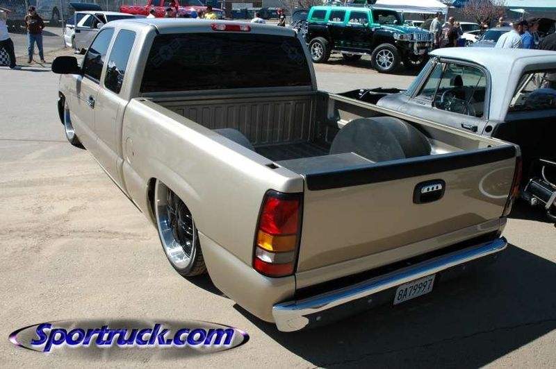

I have a 2001 Silverado with 24 inch Foose Spank 6 with 305 35 24 tires and it looks if I bag the truck that the back wheels hang out alittle further then bed. Could someone that has done one of these trucks let me know if it will lay out fine or will the rearend have to be narrowed.

it all depends on the offset of the wheel. chances are you will have to narrow the rear or get different rims

this truck we did has 24's. he got the offset just right and the fenders are slightly pulled out.

narrow axle time

Depending on how much it sticks out... It might work. U can flare those bedsides out quite a bit on those trucks. If it is slightly stickin out now and u get it to work by flaring, dont even think about bodydroppin it without narrowing the rearend because of the taper of the bedside.
