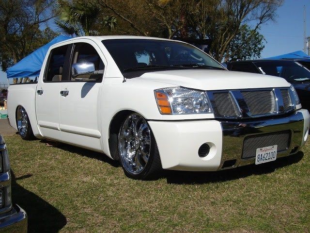

stkflrd73's avatar
stkflrd73
this is my buddys before Zing the frame and plating the bottom(cut off the lower part that hangs down)this is after only 20's though

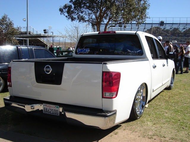

stkflrd73's avatar
stkflrd73
actually i think this is before sorry
ElCadillacKid's avatar
ElCadillacKid
well i just dirtied my underpants. your buddies Titan is awesome as well as Joenar's. i love these trucks and they look so good layed out.
stkflrd73's avatar
stkflrd73
yeah hes working on it as we speak .
shaving the tails grant customs skin and grant roll pan...
re paint it some new nissan blue color
bodydropped72
that is my titan above it is z'ed 1 inch the rear lower frame under ex cab door to about the gas tank was sectioned thats why i z'ed it. right now on 20's my driver side upper control arm is hitting the brake booster when layed out. im gonna channel the body and inch which means i really gotta figure something out with that plus im doin it on 22's
