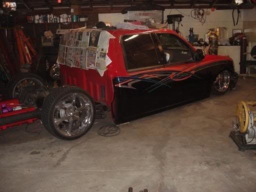

something like this?
bmxr4life87
im not sure about laying flat frame, i just finished a guys who lays HARD tranny crossmember, he has djm uppers and lowers, tubbed firewall, stock spindles, torsion bar setup with slam re7s and he is currently having a new driveshaft made but i notched the gas tank x-member for his aluminum one so he would have to tub his floor to lay with alum or i believe a steel one off of an extended cab will work also.. It has ranger like camber up front but he also has 285/35/22s and his pass side tub barely rubs tire layed out because of the blower motor
