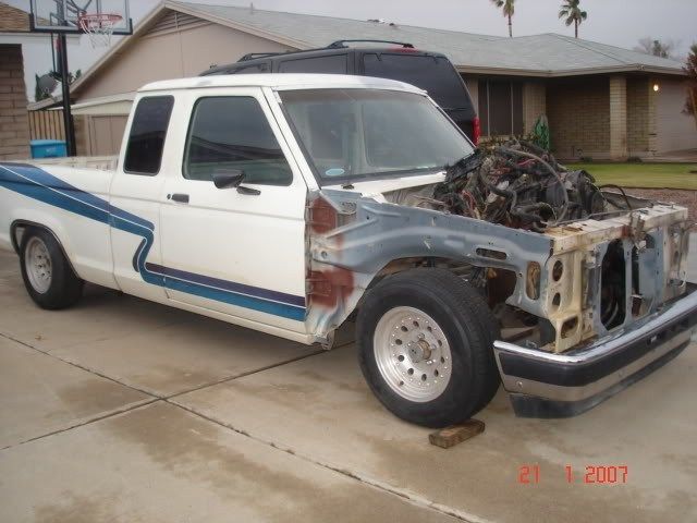

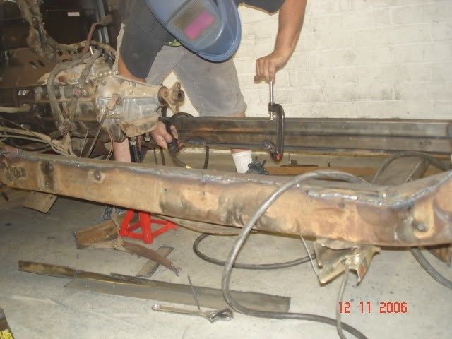

I am thinking it can be stockfloored around 3 inches with a new frame. My buddy is building an older Ranger almost to the doors and he has to go over 6 inches. This is a combo of traditional and stock floor.Here is the new frame:
Here is the truck with all bodydrop and no suspension work yet:

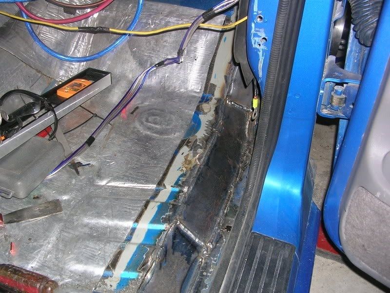

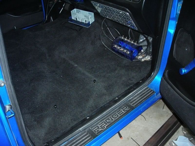

after the 2 in or so Z of the frame ull need like a 2.25 body drop. msturg on here did one on his 99 and it lays rocker.

I WOULD SUGGEST JUST BUILDING A NEW FRAME OUT OF 3X2 FROM THE Z ON BACK -- JUST DO SOMETHING PLAIN AND SIMPLE AND WELD YOUR STOCK MOUNTS TO IT -- HOPE ALL GOES WELL -- SHOW US SOME PICS OF THE PROGRESS --- MY TWO CENTS !!!
