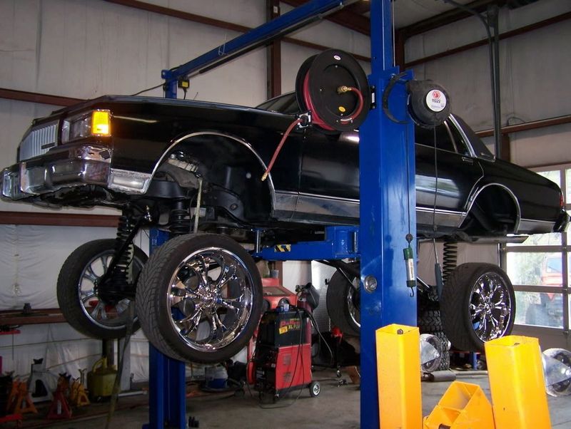

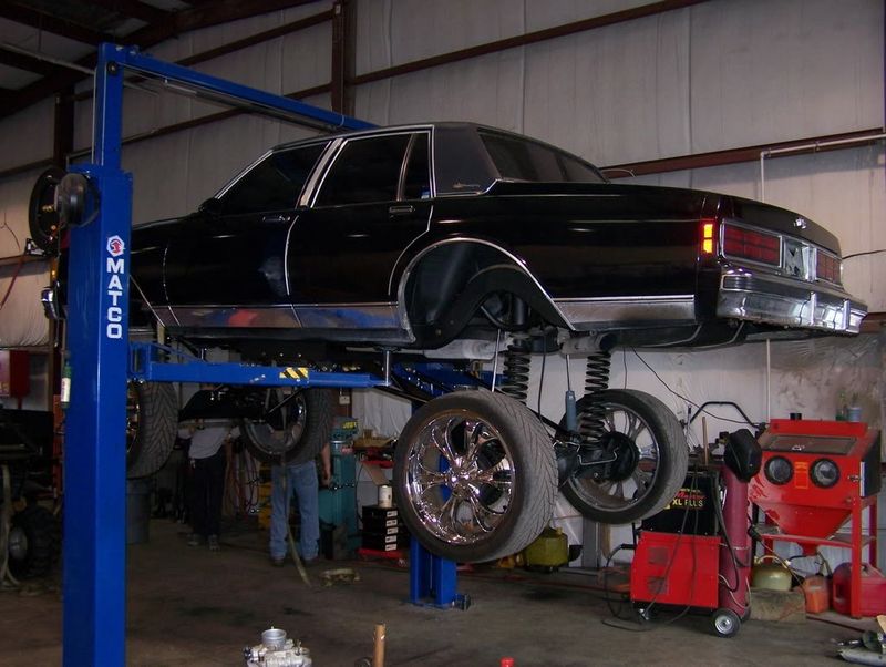

Has anyone seen pictures of the suspensions donks are running? Not the ones on truck frames or axles, the ones with like lifted caprice suspensions. How do they adjust the steering and alignment with the angles so out of wack?

specialty products makes an adjustable control arm for those cars. other then that its fabtech s-10 lift control arms and jeep tj rear coil springs. most dont have a decent alignment that i have seen. also some cut and reweld their control arms.
OldSchoolDragger
That one has solid axle in the front

i like how they left the upper a-arm

Yeah they left the a arm for added travel

The control arms have been taken off since the photos were taken.
