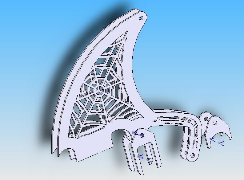

my cantilever... what do you think?

looks like it could kill a small child.......

looks clean bro..nice work!

very nice man

looks like it could kill a small child.......the very reason i have decided against sharpening it... it will be exposed through the bed (even when it ISNT dumped), and i dont need to come out of the mall to find a passed out kid and blood all over my truck
as far as paint goes, idk what color im gonna do the frame, maybe a burnt orange or white, but im considering using a gunmetal wheel coating/resurfacing paint to do the componants... and i think I have decided on Porche Cayenne gunmetal for the basecoat of the truck

Is that second cantilever designed in Solidworks?

the distance from the center pivot, to the center of the bag is the A side and the distance from the center pivot to the down arm is the B side. if the A side is 10 inches and the B side is 20 then you have a 2:1 ratio lift or if the B side would be at 15 inches you have a 1.5:1 ratio.
this one here is for my friends truck and it has a 1:1.4 ratio
nice solidworks part you have there

looks like its going to be crazy

that it will... lots of work to do still, but itll be done within a month or so
no it was made on an older program, i forget what its called... designed in 2d tho
gravity5's avatar
gravity5
yep that was drawn up in SW....great program, I can't stand autocad.
