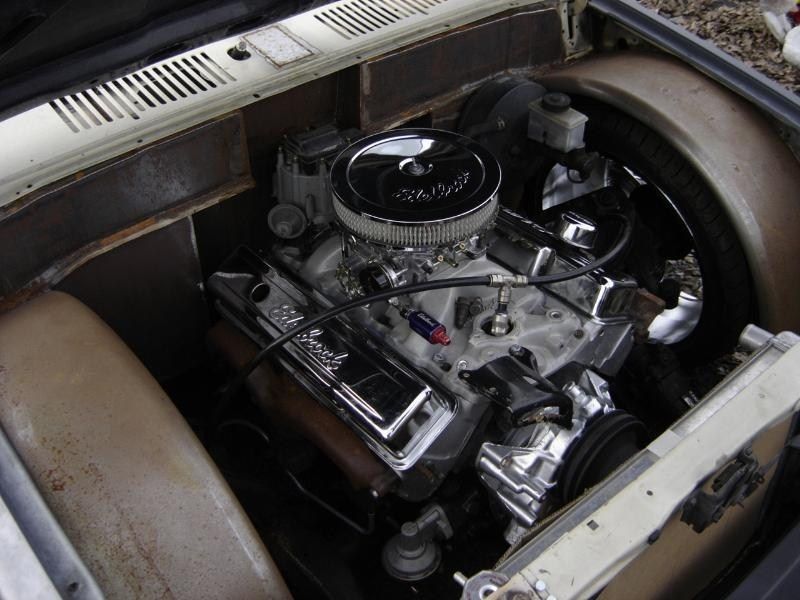

maddawg
you do not have to cut the firewall unless you use a large type distributor, even then it would only be the pinch.....but.....i highly recommend that you do go into the firewalland set your engine back a few inches ,this will give you better clearance ath the front of the motor and give you more options for external engine component configuration.it will also help with hood clearance .it will also give you more room for that 3" blowwer belt (ha haaaa!!!!). check out "plane jane" here on ssm.

dragginmazda86
checkout the pics in my profile there should be few to give you an idea of how it will sit in there. i'm bodydropped to the pinch moulding the engine sits under the 2600i hood with an inch clearance. theirs a pic of the sectioned oil pan, the motors pushed into the firewall about an inch and a half. if you need more info just ask.

dragginmazda86
thanks Rudy i didnt have that pic in my photobucket and i was at work.
