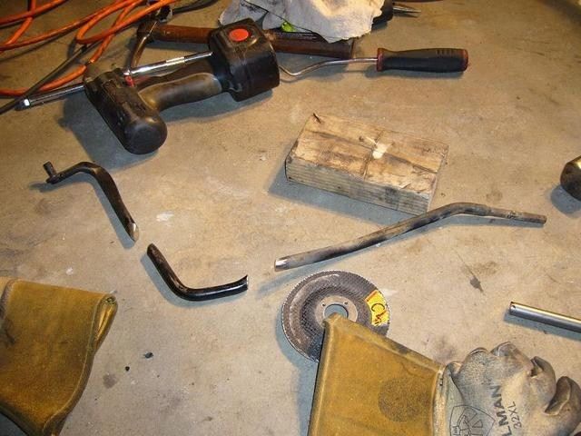

mine was bodydropped 3 3/4 inchs and all i had to do for the auto shifter was shorten it up like 3 or 4 inchs right by the transmission. i could shift through all my gears no problem. and i didn't know how to get the stock hood to fit so i ended up cutting a hole. i've seen one person change their pully set up from a one belt running everything to 3 different belts running everything.
8D
89s dime
ya i had to cut out the angled part and welded in a straight piece instead so it wouldnt smack my frame
I dont have a pic of what it looks like finished
