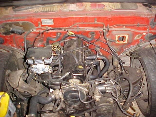

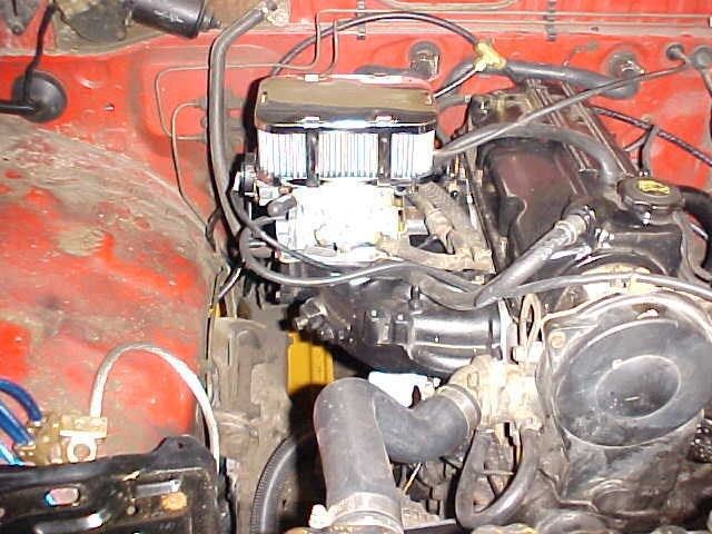

i got an 89 mazda b2200 automatic and i have a weber on it. worked fine. the header i came into a prob with hitting but i got that fixed.

LMAO YEAH RIGHT....It works...Fits and run amazing, starts everytry...I have an 88 b2200 with a webber on it...Never had a problem....ever...And its an auto...so they are full of it, I ordered mine through them, so call them back and talk to someone else...That guy just musta been an idiot
