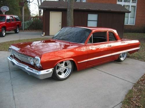

DON'T BODY DROP IT BRO, LEAVE IT O.G, HERE'S MY IMPALA ON 22'S......
