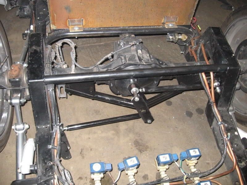

I will build you one like the one we did on this F 150 for $350 602 216 2673

beautiful work Troy

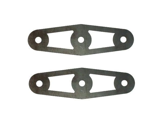

Theres lots of ways to do the crank.If you are going to use heims on the bars, then all you need is a bar end for the center of the crank. Simplest way is to just sandwich a standard poly bar end between 2 plates. If you are going to use heims on each end of the links, you'll probably need spacers as well.
If you are interested in a nice looking crank, let me know. I have a few designs or can do something custom for you to your measurements. This is the last set I cut. For the price it sure looks alot better then most of the ones posted. Well troys looks good. The rest look pretty amateur.
