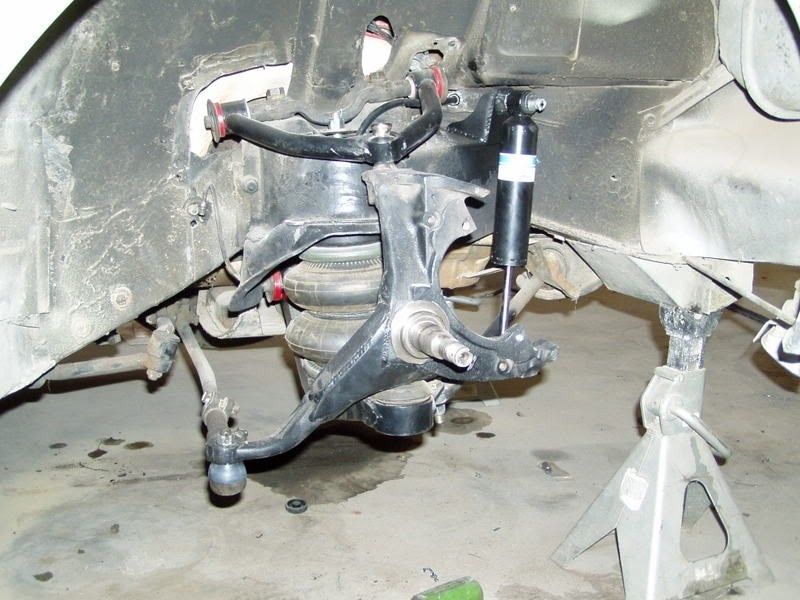

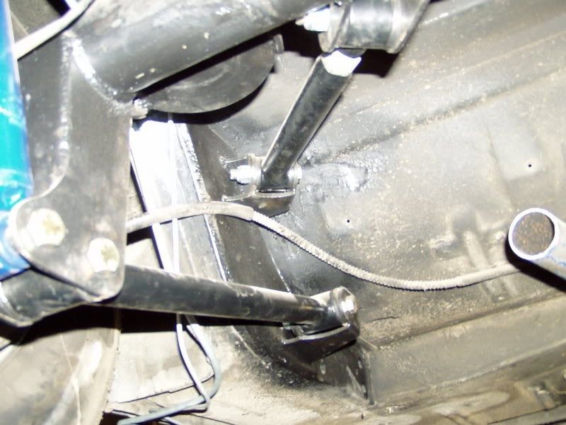

Here are some pics of a '61 that we recently did. The '69s are different, you can't run the upper bars triangulated so you need to run a panhard or something of the sort.
The front suspension pic is the kit that we built for the front of the non disk brake Linc's to convert them to disk using a '88 to '98 full-size Chevy spindle. The spindle also acts like a 1 3/4" dropped spindle laying the big bastards out with no cutting.

I do sell the kit. There is a lot invloved, but they work really well. A complete kit would run $1500 without brakes or bags. The only thing you would need to weld on would be the upper shock mount.
The floor on the '69 is shaped very differently. There isn't any room to triangulate the bars, but you can fit a straight bar on each side of the frame.

No, the cut off is '63 or '64 I don't remember. I have a '65 and it won't work on it either.
