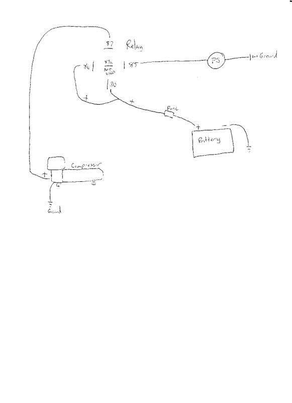

what's the best way to splice the relay into my wiring?where is the best place to put it?wish i would've put it in when we installed the airride.
h2omelon(nick)'s avatar
h2omelon(nick)
sorry for the horrible drawing but this should get you started

thanks nick.could you make the drawing a little bigger,but it definitely helps me out alot.
