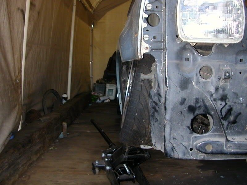

where does everyone get their balljoint s out to lay on 20's? asking for a friend so the more info the better. thanks in advance!

i was able to lay 20's with the stock ball joints and spindles.i'm currently useing S-10 ball joints now because my sway bar is mounted on the upper control arms and i wanted some thing stronger.

the ball joint will fit the spindle (top) on the stock one and top and bottome on a drop spindle but you will need to shim the upper with 2 or 3 washers( you'll know what i mean when you slip the upper ball joint into the spindle and start bolting it in.
however; they will not fitinto the stock upper control arm you'll need to tweak that (drill new holes)

pie cut the upper control arm and bend the balljoint down 13-15 degrees then weld the control arm back up . will alow it to lay on 20s

you will need to do that if youdon't wish to use spindles.
a big benefit to pie cutting instead of spindles is that the suspension will camber sooner and giveyou better clearance...especially if you don't have (or can't get )wheels with a 7" backspacing.
it will allow you to clear you fenders with a bit less.
