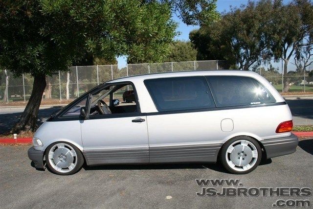

I found this one, but they are having problems with the rear obviously, so it doesn't lay out right

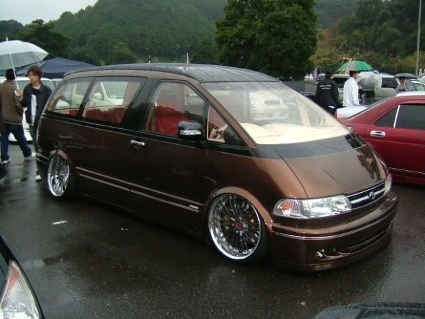

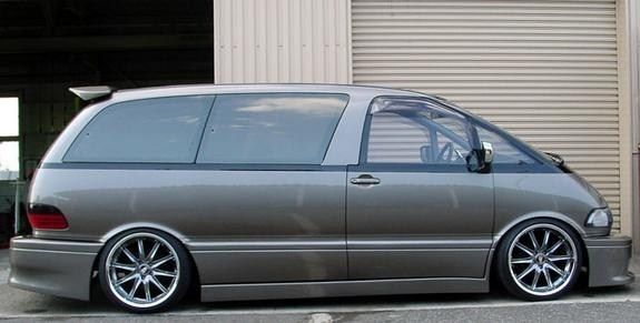

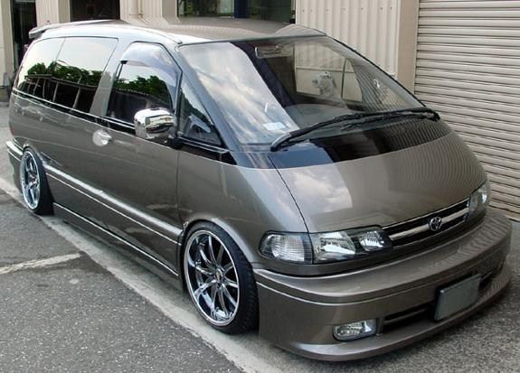

USDM Previas came with a 4-link, live axle rear that really limits how low you can go in the back without performing some extensive mods. If you want the back to lay out and tuck even an 18" rim, you'll have to actually notch the frame rails a tad, and make some bent upper links (remember it's a unibody though, so the frame rails are not like truck rails, per se). In Japan, the later Estimas (their version of the Previa) came with IRS that allow for a lot more flexibility as far as sliggity slamming is concerned. A lot of the older Estima guys swap in the later cars' IRS also. Here's some Japanese Estima pics for inspiration... note that 90% of these guys in Japan daily drive at these heights on coilovers, so most of the time, they're not even bothering with air...

What size rims is the last one, they look big, i like em

The brown Estima is just running 20s... and actually, it's the same car as the orange one right above it... just a year later, and a lot of changes. Its fenders are radiused to fit perfectly over the 20s. And that's why it's almost on the ground, yet the wheels aren't all sunken up in the fenders. Oh yeah, and ride height on that car is just about an inch higher than what you see in the pics..!
