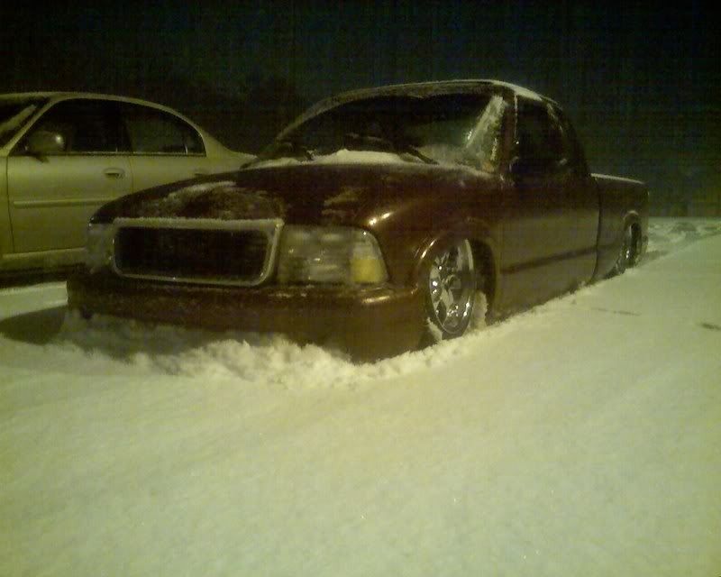

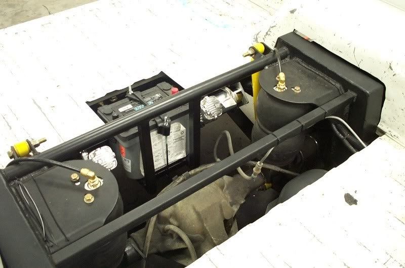

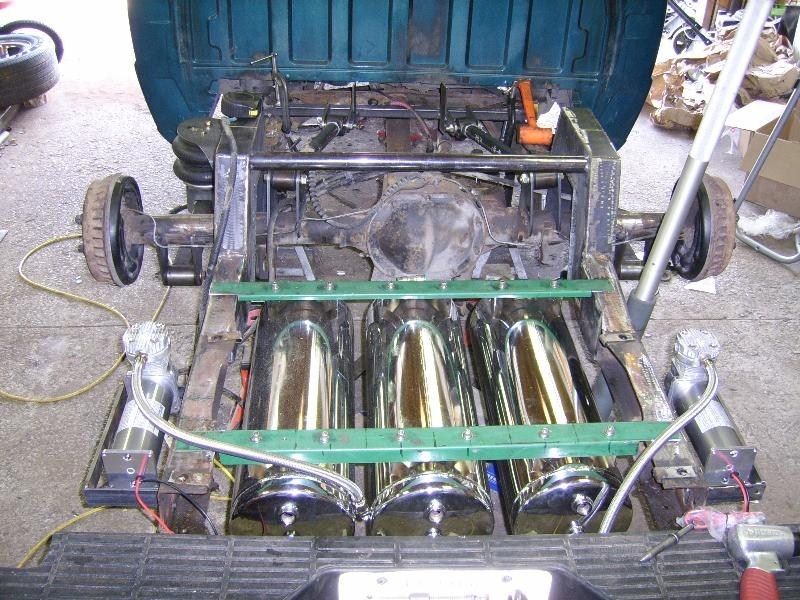

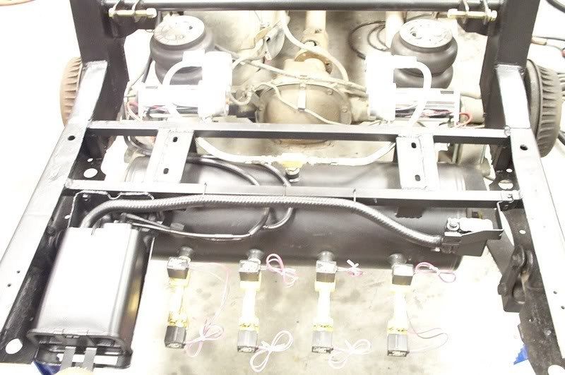

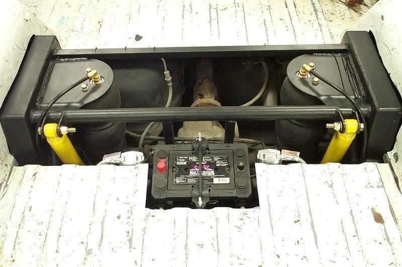

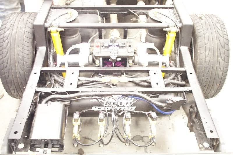

here is mine. I used the line that comes with the comps. to run the line up into the bed. If it sucks water in the comps then they will lock up, and then u might get it to work agin if you get the water out. but so far i have had no problems and i drive mine every day untile i can get the honda put back together.daily even in the snow, after thought
