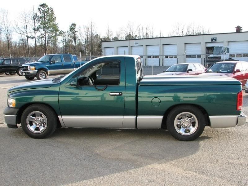

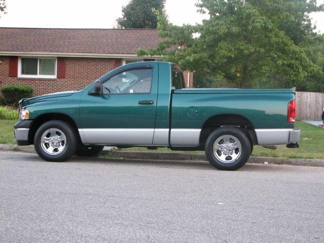

well i got the kit on yesturday. heres a before and after pic.

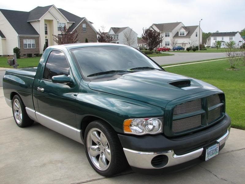

heres another updated pic of my truck, ive added an srt10 hood,shaved the antenna, rollpan and 20s.

Looks great! What size tire did you end up running?
lowbody's avatar
lowbody
i ended up running a 275/40/20. i have no rubbing issues and it rides really good.
