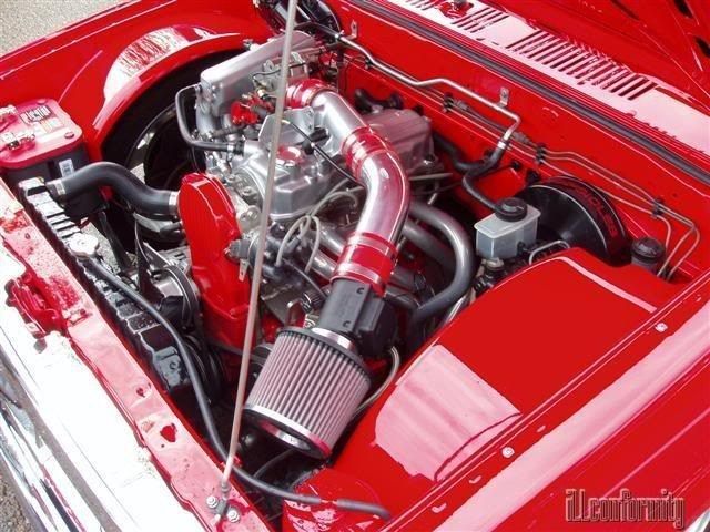

i want to do one exactly like the picture were could i get all the stuff if i were going to do something like the one picture i like the one that was on ur truck but i prefer to let it look like the pictures right next to this message could u help me out russ it be really helpful

upload the full size image, I cant see anything in that picture. But I'll help.

THere it is thanks for ur help

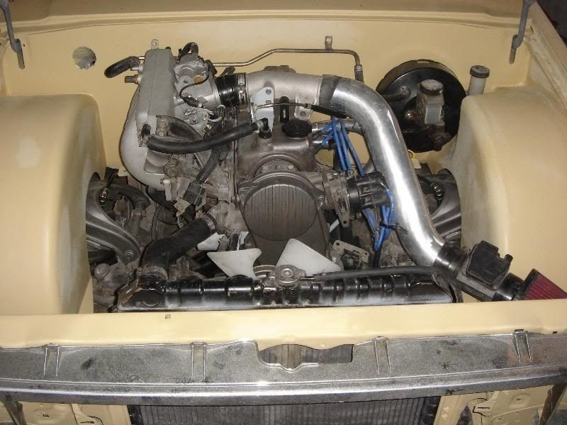

Or something like this
