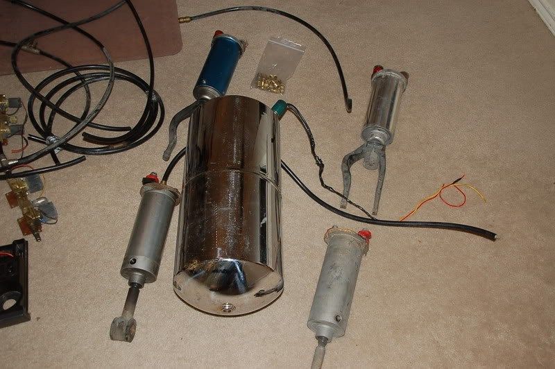

Phil I am having the same problem witht he cylinders leakin down, Below is a link to a picture of my cylinders. Are they rebuildable? Or can I take them apart and clean them out?

The Blue one is from EAI, it is rebuildable, if you can get the seals. I have a few seals instock, but the can might not be worth saving. The other 2 grey ones are Chassis tech. And the chrome one Im not sure of. Call me if you need any further help.

Are the chassis tech ones rebuildable?

I have re-built the chassis=tech ones before. People say they are not rebuildable, This is not true. As long as the cylinder walls are not scrored you can just re-seal them. Most of the times it works when you re-build them.
I have honed the walls of the cylinders before and put new seals in, I upgrade the seals and use a U-cup seal intead of the standard o-ring style. They seem to work better.
The chassistech ones screw off from the top and bottom.
