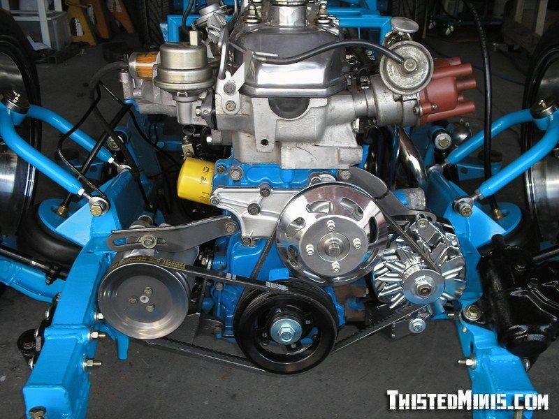

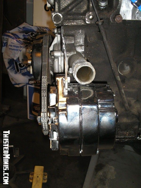

I put a GM one wire unit on my truck. 100 amp Chrome one for $90 shipped on eBay.
flameds10(tyler)'s avatar
flameds10(tyler)
what mods did u need to do to get that alternator on there seth, cause i've been lookin at that also
TwistedMinis's avatar
TwistedMinis
I made a new lower bracket, and modified the upper bracket to get the pulley to line up. Its really close to everything.
I ended up adding more support to the lower mount before sendign it to powdercoat. I added a finger that wrapped around the front to hold both sides of the alternator to keep it from deflecting or flexing.
Its really close to everything. With a belt tight on it, I've got about 1/4" between it and the steering box mount, and about 3/8" away from the motor mount, and real close to the radiator hose mount.It looks badass though.
Different truck, but it should be the same concept with modifying brackets and all that.
