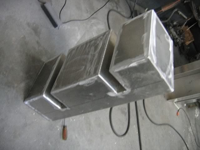

not trying to highjack the thread,but does that last one have three pickups?

Nathan, there are three vent tubes on the opposite side to allow the trapped air to escape when filling.

cool, i was looking at it upside down.
