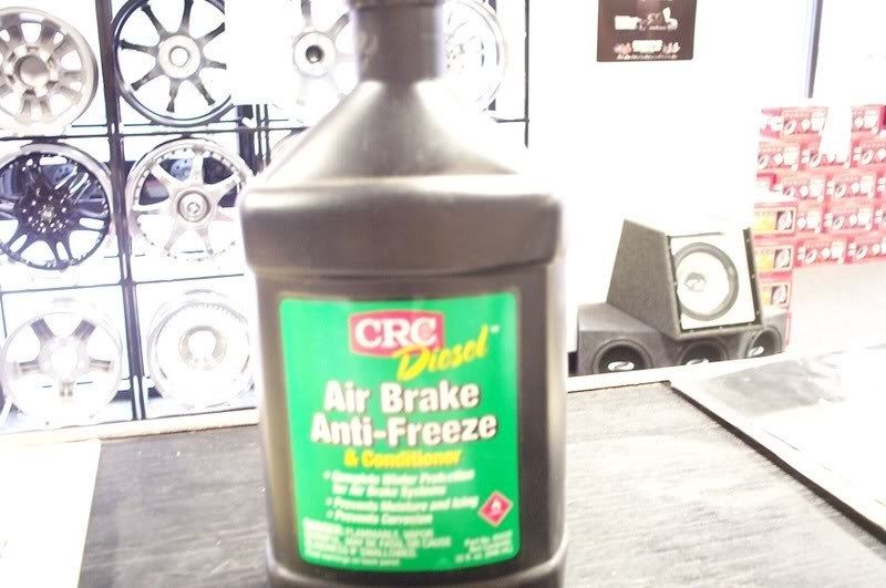

NAPA carries air brake anti freeze. get a bottle and put in youre air tank. after you cycle the system a few time you shouldnt have any more problems.

does anyone know how that air break antifreeze works? there has to be a good way to pevent valves from freeze is the CRC air break antifreeze the way to go? is that what the big rigs run in there bags and breaks?
