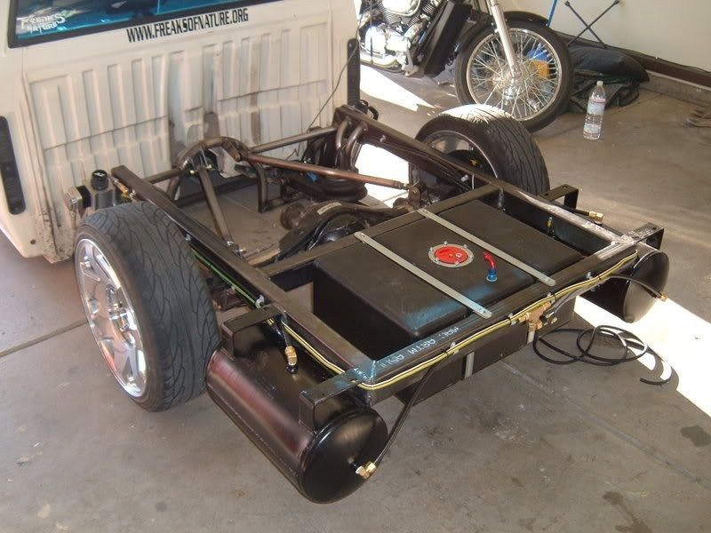

The reason I say that is because there is no need for that high of a beam hight on such a light truck, 2x3 .120wall works great and slides right into the stock frame. I got my fuel cell from RCI and then had it polished, it came out pretty good and RCI is a good company.

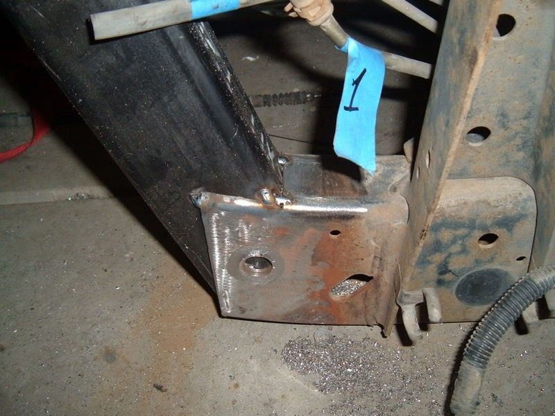

This is mine. I havent had any problems with it. Its hard to tell in the pics but I did add supports to the front x-member where the four-link bars are mounted.

ya i like that man,looks really good. is that 2x3 or 2x4? does that new piece go all the way to the inside bottom of the stock rail?thanks man that really helps out.

I used 2x3. And yes, the 2x3 goes all the way to the bottom of the stock framerail (on the inside).

did u have to weld that peice to the bottom of the stock frame rail (on the inside)
