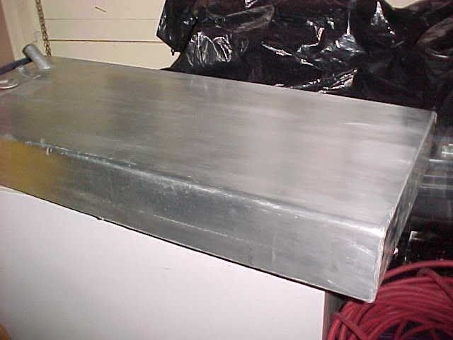

i got a stainless steel gas tank and i want to pollish it up. actualy its a christmas present for my brother and i want it to shine!!!! how does everyone shine up there stainless stuff???this is how it sits as is... not too great lookin.

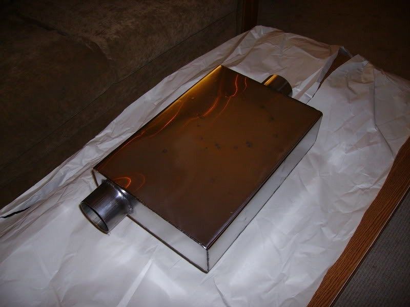

Here you go for the pics!
minitrukinranger's avatar
minitrukinranger
Go to Home Depot and get some polishing/cleaning compound for stainless (hard metals)and a buffing wheel and get to work

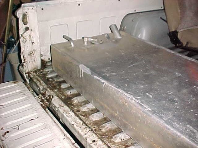

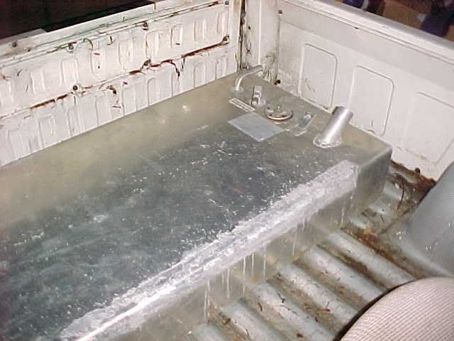

Hate to be the one to say this but your going to have to grind the flaws out of that tank then sand the grind marks then sand the sand marks then polish the sand marks.stainless is hard as a rock and shows everything.The easy way to do it would be to scotchbright sand the tank in a even pattern and make it look brushed.some people use steel wool.

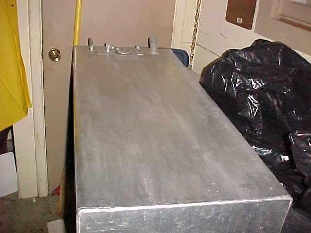

alright so i guess ill just wash it than hit it hard with the steel wool! ill post up some pics tomorrow.
dragthatbitch
id start with a da sander to clean up the imperfections first.....then go finer and finer till you can buff it out.Lots of time though. I don't know if its just me but it looks a lot like aluminum???
BK2LIFE's avatar
BK2LIFE
yea to me that tank looks like aluminum also. if thats the pic to the tank you wanna clean up, your in for a lot of work, your best bet is painting it
