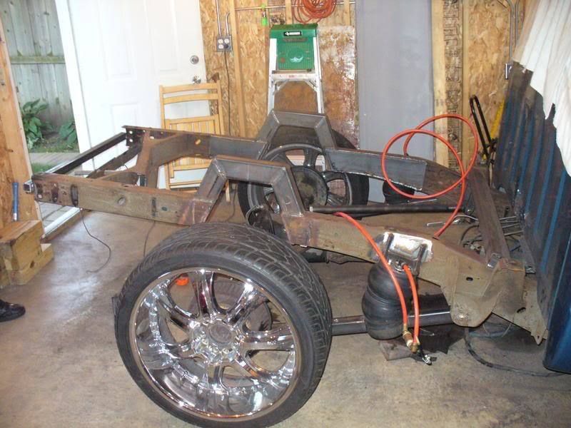

So I will try and post a pic. Of a setup I found on a sb Chevy. Do you think it will work on a dually?
ben_shady1
You plan on towing anything?
azhooligan
Yes. I must be able to tow my 28 foot toyhauler to the dunes.
bdydrped's avatar
bdydrped
im runnin my bags on the links like that... had an xcab 1/2 withthat kinda setup also that used to pull my 24'car hauler trailer with...
wont be able to haul lots of weight withthem up front like that,but if you arent gonna be towing all the time thats gonna be the best ride/lift setup to run and still be able to tow
dragnasty's avatar
dragnasty
I dont know if I would recomend that setup for a 1 ton pulling a trailer. On a 1/2 ton maybe.
ben_shady1
I'd put them on the axle if I were you and your planning on towing some weight.. Just depends on what your tongue load is on the 28 footer...
azhooligan
Yea I have been looking and it looks like this is a no no for 1 tons. Thanks guys

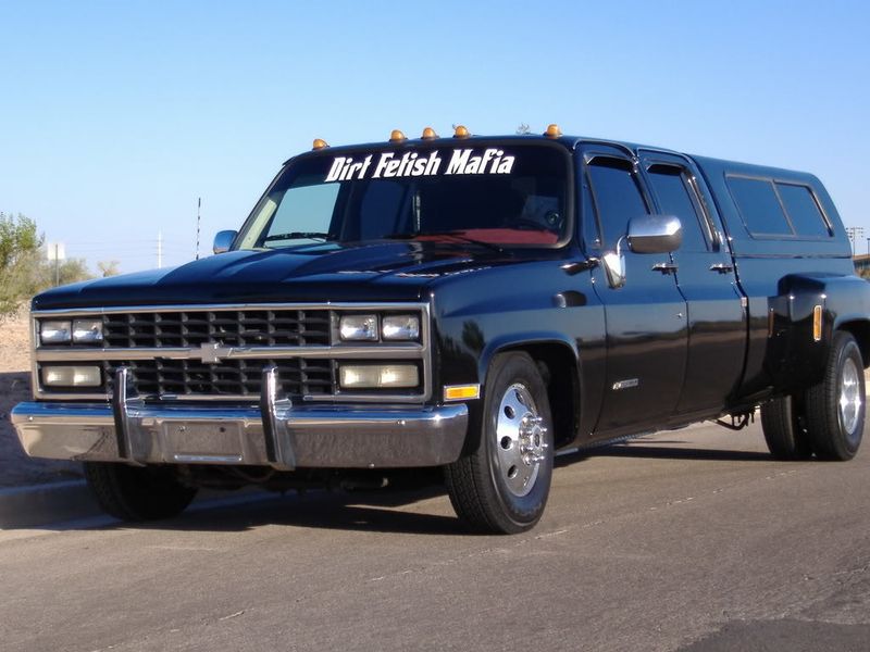

Last Ride!!!
ben_shady1
Nice truck.... Looks like mine.. with some shine and a newer front..
