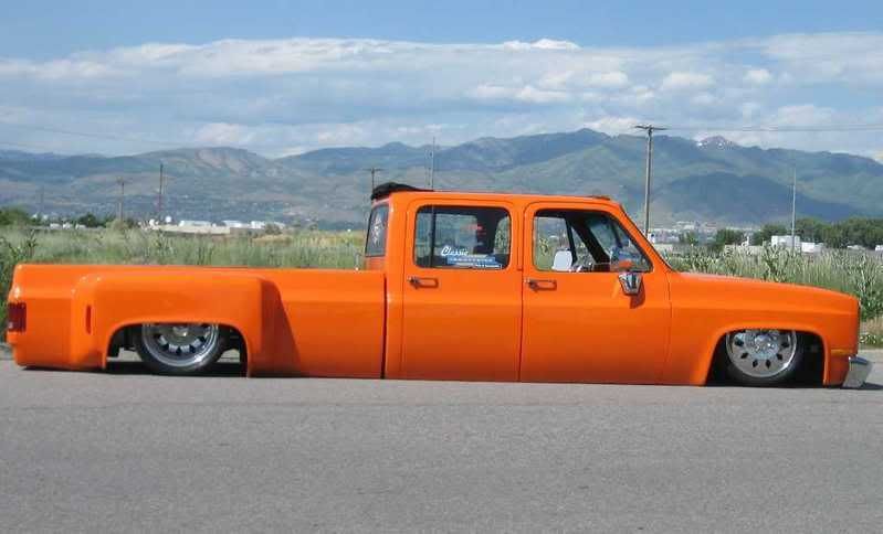

Jeff's dually with 24's all around
low95xlt
looks a lil odd since it has the 6 ft still nice jsut a lil out of proportion to me
maz89
yea, I'm not crazy on it either, I just love how the front tucks.... But the bed sides do hold the 24's, just the dually fenders pretty much have to go to the top of the bed... which sucks...
ben_shady1
So they will fit... it just puts the top of the fenders at the top of the bed.. Well that does suck but at least they fit..lol Anyone know if a 275/30/24 could handle alot of weight? and if not then what's the biggest tire could I fit in the rear? Mine's an 88 so it may be different than that white one...

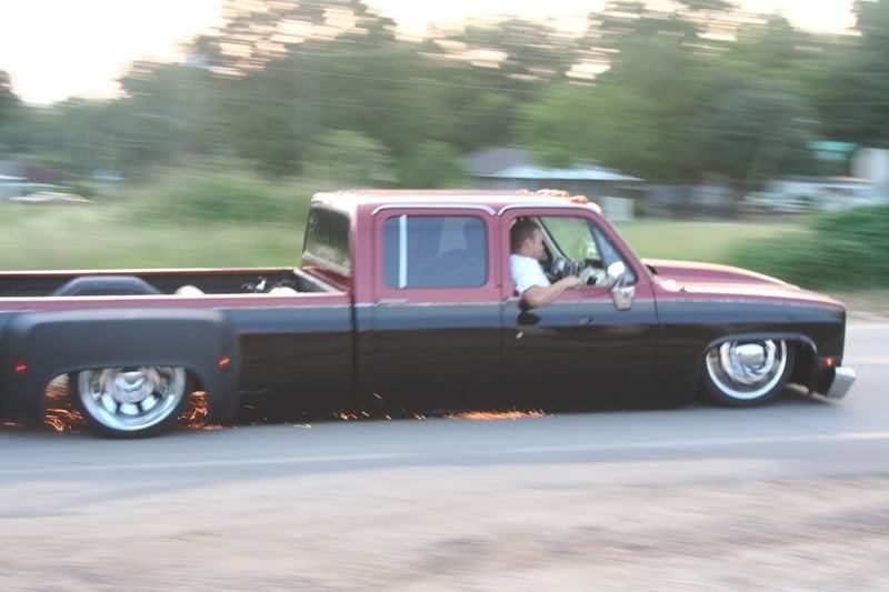

huskerdually
This one is to the doors on 22's so that is like 3" lower than just to the rockers. The 24's most people are running are only like 1/2" bigger than the 22's.
And here is the former dragnasty he was running 22's with a bodydrop you can get and idea from where his fenders are.
