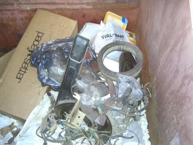

ahh, one of my favorite pics ever! all that crap in the dumpster were it belongs.
