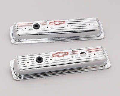

I want to get either the chrome or black crinkle finnish chevy valve covers. They are on jegs but every place I look says up to 1986 I have not been able to find any that say they will work with my 98 Tahoe 350. Can someone help me find something that will work on my turck.

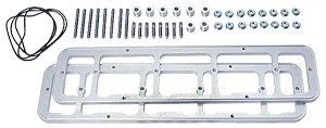

you will need to get some of thesethey are adapters to run early style valve covers with your late model center boltsJegs part # 555-50120

awsome...is that the only way for it to work? or is there other options? because $70 for the valve covers and $126 for the adapter is a little more than I expected.

yeah it sucks there are some on ebay buy it now 89 bucks the other options would be way more expensive, summit has an adapter for 100they also have theseSummit part # PRO-141-131 They say that it is a black wrinkle finishSummit part # PRO-141-107 or you can get it done for less than 10 bucks just Take your valve covers off and add this

I guess I gota get the adapters because I want it to say chevrolet on it and my stock ones are shity as fuck looking and would be pointless to paint. thanks alot man
